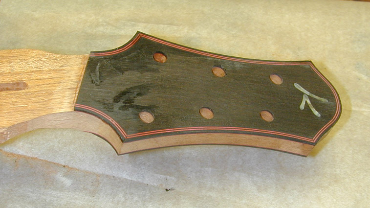

PostPosted: Tue Jul 24, 2007 10:28 am
Hi Dave ... funny you mention binding one .. here is one I just did yesterday .. 4 hours effort start to finish ...
The way I do them though, I dont need any extra wood. This neck started out as normal, I scarfed the headstock on, it was a bit thick to allow for the fall away angle of the face of the headstock. So .. plane in the angle as required by the nut angle. Then joint off the extra side wood such that the headstock is now only slightly wider than the nut width of the fingerboard. Now add on some headstock wings cut from the same board. Replane in the headstock face angle to match the nut angle. Thin the front and rear headplates, and glue on the top one only (this one also has a red veneer under it) cut again at 13 degrees (my headstock tilt angle) and to match the nut angle as well (compound cut). Now in the thickness sander thint he whole headstock on an angle to required thickness, taking into account the rear plates if using one (agian here, ebony plus the red veneer). Bend the rear plate volute on the required angle (I have made a simple press with the curve and nut angle taken into accout, thing of beauty to do this) Now glue on the rear plate and veneer.
Now to bind - since I used ebony for the binding, I simply routed to correct width (binding plus the red/blk/red inner purf) to a depth that only goes thru the thickness of the top plate ebony, leaving the red veneer line underneath it !!!! Bend wood, bend more wood after breaking lots of ebony, Ccut mitres, throw bad ones away, recut mitres, and start gluing on .... Four hours passed ... DONE
